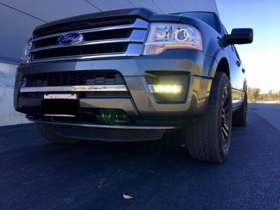

looking to lift mine. Wanna see what everyone's got for these specific years
I talked with several top lift shops including skyjack and readylift. I first was looking to see if ready lift would custom make me a rear set because I'm not interested in leveling my ride as I tow a lot and it sits level when I tow...that's the reason it's 1" higher in back...assuming you're going to put a load on it since it is a truck.
Several lift experts talked me out of the spacer option for many reasons. It is the only inexpensive route but it will affect handling...slightly. There's aftermarket stabilizers by Eibach that will help reduce sway and cornering.
If you want to lift it right you have to have a custom set of coilivers made and I was referred to King shocks as THE choice by the lift experts. I haven't got a quote yet but I was told $1200+ per shock.
I have a '16 Limited with slightly offset wheels which definitely gives it a more aggressive stance. I'm ordering the '18 model as soon as my sales guy gets the green light for preorder. So I'm not going to do it till I have that model.IMG_3952.JPG

View attachment 19957 View attachment 19958
I have a '16 Limited with slightly offset wheels which definitely gives it a more aggressive stance. I'm ordering the '18 model as soon as my sales guy gets the green light for preorder. So I'm not going to do it till I have that model.View attachment 19956
Penumbra, thanks for those pics. That look is what I'm going for. Not going to be towing anything, just want it a bit higher with a wider stance. Everyone here in this forum seems to recommend readylift as do the local shops around my area. What size tires/wheels you running on?

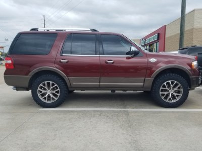

I just lifted my 2015 2 inches front and rear since it doesn't have the same rake that previous models had.
I feel like it's level.
I also put on 275/55/20 Nitto mud terrains. 20170417_164722.jpg
