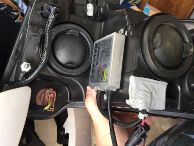

Don’t you have to splice in to the wiring to do the projector upgrade?
You have to run the wires in side the housings. They provide a round rubber plug that requires you to cuta 1" diameter hole in the rubber cap behind the bulb If you seal it with silicone you can make it fairly water tight. If you ever need to do a warranty exchange you can just order another rubber cap.The hid I meant, so they are plug ins. Does the housing need any modification to them?
Ok gotcha I thought you had to splice in the wire and cut a bigger hole in the housing.You have to run the wires in side the housings. They provide a round rubber plug that requires you to cuta 1" diameter hole in the rubber cap behind the bulb If you seal it with silicone you can make it fairly water tight. If you ever need to do a warranty exchange you can just order another rubber cap.
Nope. All plug and playDon’t you have to splice in to the wiring to do the projector upgrade?
If you want to you can cut two holes in the back of the big rubber plug one for the 1" rubber plug supplied with the HID system and the other to fish the connector inside the housing. Once you have everything in place you can silicone the hole closed with black RTV sealer. I chose to go through the back of the housing using the rectangular cutout that's covered with a rubber tape.

Same system as Andy has, but I changed the wire route a little to exit from the rubber dust cap.

Yes this is my installation. @mossback definitely has a cleaner installation. This was my final solution.Do you have a picture of the finished HID headlights?
