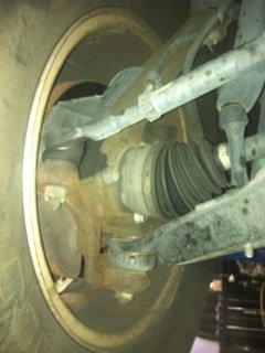

Only downside is that I need new rear brakes (down to about 2mm) and need a right outer tie rod - never done one of those before.
I hope to do the brakes today or tomorrow, using Duralast Gold brakepads. Anyone have any thoughts on these???
