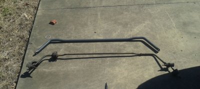

BTW these are the parts added all from Amazon and a comparison pic.
Stabilizer Sway Bar Link Rear LH or RH for 03-06 Expedition Navigator Truck SUV
Belltech 5550 Rear Anti-Swaybar

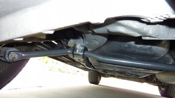

Dog it! Looking at you pic I see that I put the part that bows in the up position. God I got to fight with them bolts again. THis time with lock tight on them :(
Hamfisted
Nov 20, 2012
2,599
1,478
Ft Lauderdale
Yeah, I don't know, I thought it could only go on one way, but it's been a long time since I did the install.
