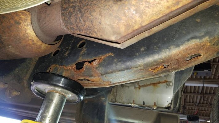

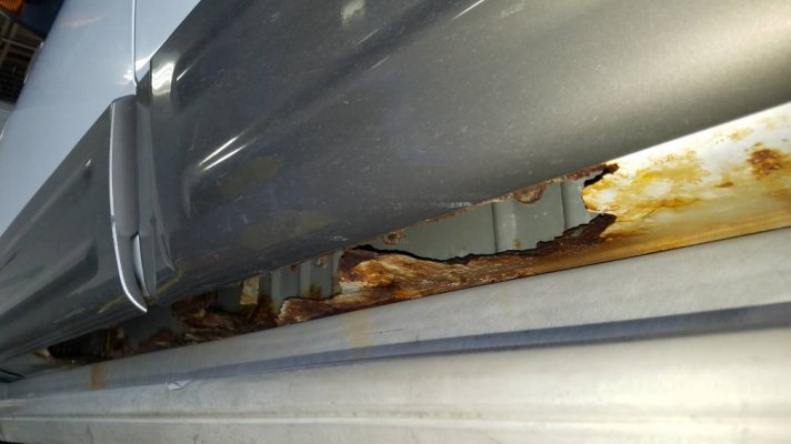

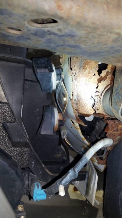

2004 in for state inspection....
ThwopKing
Mar 10, 2012
134
46
Bunker hill, WV
It did not go well..... just one reason i stayed away from these In this area...b00a3f8b6394dcbba6b435be2078b835.jpgeb5964f9f02db4f46d77c8033733fcd5.jpg47ef0a83569a5af240de4de0b9b27d83.jpg61b657e3e9d8cc318c30254945f7562c.jpg53ef5e5401df187d7cc469951001fc60.jpg

Ohhh this wasn't mine lol.... was a random customers.

Did it pass inspection? Is that repairable?

Did it pass last year?
Got to make these things lighter somehow for better MPG, right!

I'm from Chicago and when I first moved here I was like ...wtf is a state inspection? But it checks over A LOT. The vehicles owner had just moved to the area but from Baltimore md, so I'm sure they knew the condition of it.
