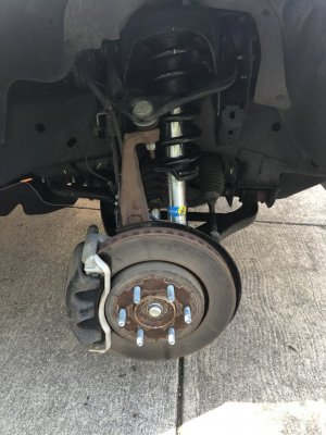

    Yes. The 15-17 Expedition shares a front with the F150.
    It utilizes a crossbar through the shock eyelet and 2 bolts into the lower control arm.
    The older Expeditions used a single bolt through the shock eyelet to attach to the LCA.
    Prepping to install mine as we speak.

    Send pics when its done.

    Yes the Bilsteins come with new lower hardware as the bolts are pressed into the OEM shock mounting bracket.
    If you are wanting standard ride height don’t waste the extra money on the 5100s just get the 4600s.
