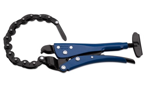

I have a pair of what looks like channel lock pliers and it has what appears to be a length of chain saw blade attached to one arm and a loop to catch a linkage of that chain on the another. I think they came from Harbour Freight, maybe $20. Pretty much wore them out after one cut, but no sparks, got into a place where a saws-all couldn't and made a nice cut.
Example:

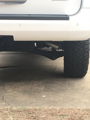

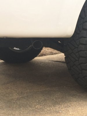

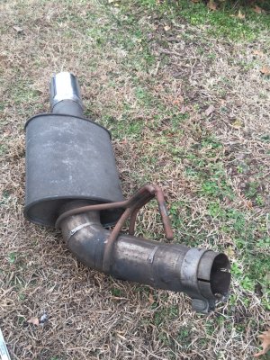

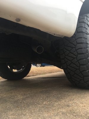

Alrighty fellas! Today was the day. Loosened the clamp up above the suspension and took off the rear muffler.C58DEC98-079E-4A9D-AF8A-44BB4A3C4727.jpegNext bought a $20 piece of 3” ID to 3” OD 45 degree pipe and clamped her on41BB09AC-EF8A-4238-BD7F-E8A3B5AFDB0F.jpeg
Dumps right behind the wheel. Might extend it a little and secure with universal exhaust hanger7F047D75-2530-4016-B8AB-F5811CCE923F.jpegA69D482E-7573-4A11-A080-E6783B6AFCA7.jpegSounds ALOT better too which I’m surprised. Little throaty
