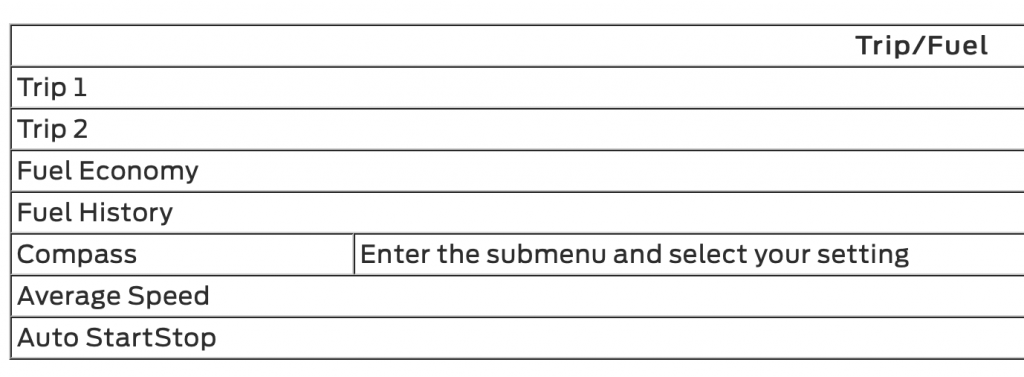

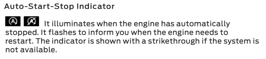

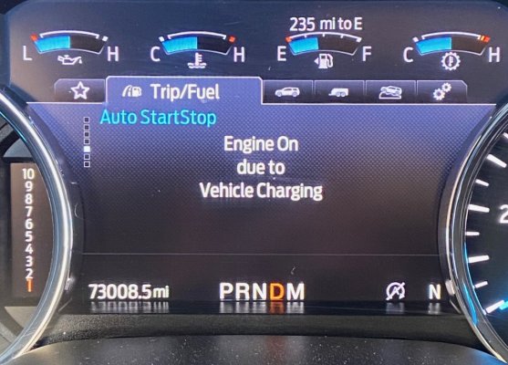

We bought our '20 in December 2022, original battery, and mine has never activated either. I discovered a "screen" in the Information Display that indicated AS/S did not activate due to battery charging. When you are stopped and see the grayed-out AS/S indicator with the line through it, you can select this screen with the arrows on the steering wheel. It's in the Trip/Fuel section at the bottom of the options.
Another symptom I was getting was the car entered Deep-Sleep mode in the FordPass App due to low battery on every shutdown. A battery load tester indicated my battery is not optimal, but still strong enough to start the car. I began putting the battery on a maintainer overnight, and this stopped the "Deep-Sleep" messages, but still no AS/S. I am not spending $270 just to restore AS/S.
