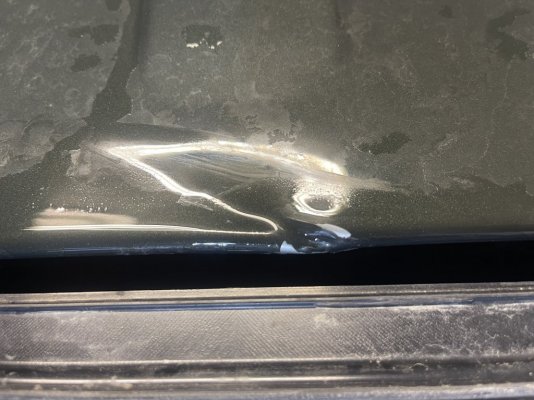

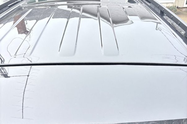

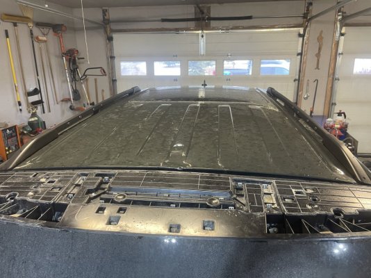

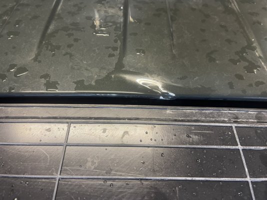

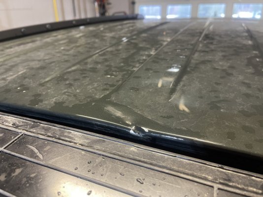

SSM 51346 - 2022-2023 Expedition - Liftgate Spoiler Contacting Roof In Freezing Temperatures - Released February 07, 2023
Some 2022-2023 Expedition vehicles may exhibit the liftgate spoiler contacting the roof during freezing temperatures when ice is present. Engineering is currently investigating this concern. To correct the condition, repair the spoiler and roof per Workshop Manual, Section 501-03/501-28. For claiming, use causal part 7844210.

Can confirm. Ford contacted me yesterday letting me know they have reversed the initial decision to deny the claim and will be covering the damage 100% under warranty. My vehicle is at the dealership in the body shop now and they confirmed the same.

I got a call from the one dealership that said that Ford rejected the claim at the beginning of January. They said that if you had paid to have the damage repaired that they would try to submit the cost to Ford to try to reimburse you.
