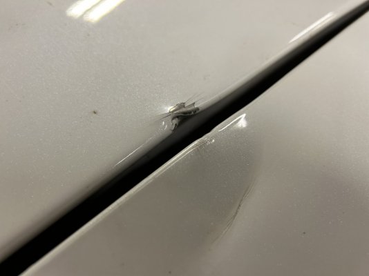

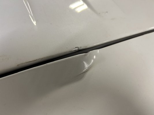

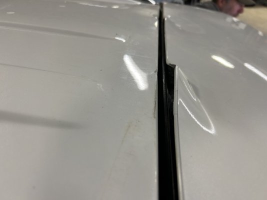

Did you ever get answers? Same thing happened to my 2022 Expedition king ranch. Damage looks the same but my spoiler is hanging loose and banging around when driving. I’ve read through this forum and sent the SSM 51346 TO the FORD DEALERSHIP and was told that SSM# does not exist and will not be covered?? Help with next step?
That dealer is BS'ing you saying that SSM is non existent.
