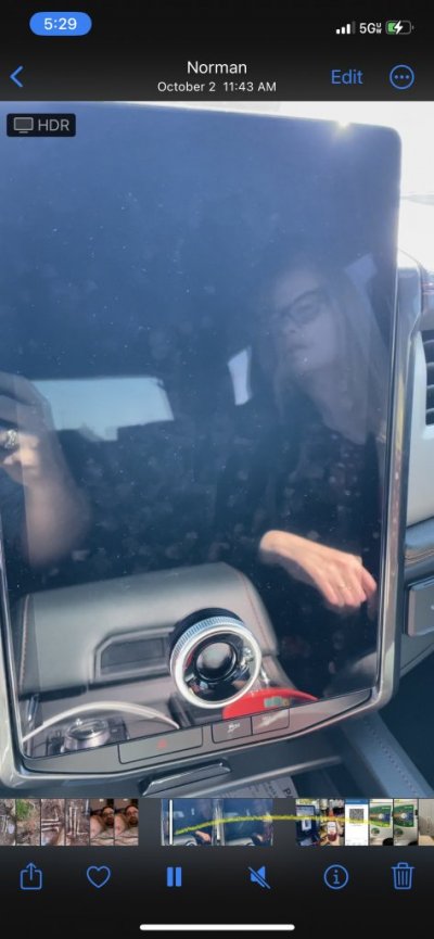

I’m about done with this Expedition. Just had my HVAC module replaced because at 7k miles it got stuck blowing hot full blast. Several little things have gone wrong/broken from the factory.
So the 15.5” screen keeps dying. It’s just black. I have no controls at all with it. There is a service bulletin for it, and this dealership says over half the timberlines it’s seen has had the screens replaced from the service bulletin. The issue I’m having is mine isn’t throwing a code, like even if I take it in to the dealership when the screen is dead, there is no code, so Ford won’t warranty it. I’m not even really sure where to go from here.

I had something like this happen to me the other day - I was driving and the screen froze-up then went black. Designers usually have some way to hard reboot their devices. I thought that since there is only one button for the interface (you can "push" the volume knob) then that's probably it.. I held the volume knob down until the screen rebooted. It probably took 10 seconds or so.
Maybe it was just coincidence, but it got me back up and running.

The far left button on the wheel (vol down) and the far right (next station). Hold them down at the same time will reboot the screen. I have used this twice when my Nav was not working.

I’m aware about how to reboot the system, I have to do that regularly as wireless CarPlay crashes all the time and I have to reboot the system to get it to reconnect.
The dealership is saying that it doesn’t meet the requirements Ford has set in the advisory bulletin, because it doesn’t store a fault code. Even though they have literally had eyes on it not working. Basically the dealership isn’t doing anything because Ford won’t pay them to fix it.
