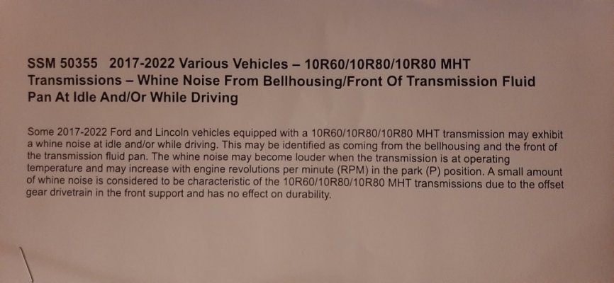

Thirdly The truck from outside has a terrible whine that my 12 f150 3.5 ecoboost does not have, but this does. The only difference is trans setup. Was not told any further information, since dealer could not re create noise. Happens every time while running.

Thirdly The truck from outside has a terrible whine that my 12 f150 3.5 ecoboost does not have - need audio clip

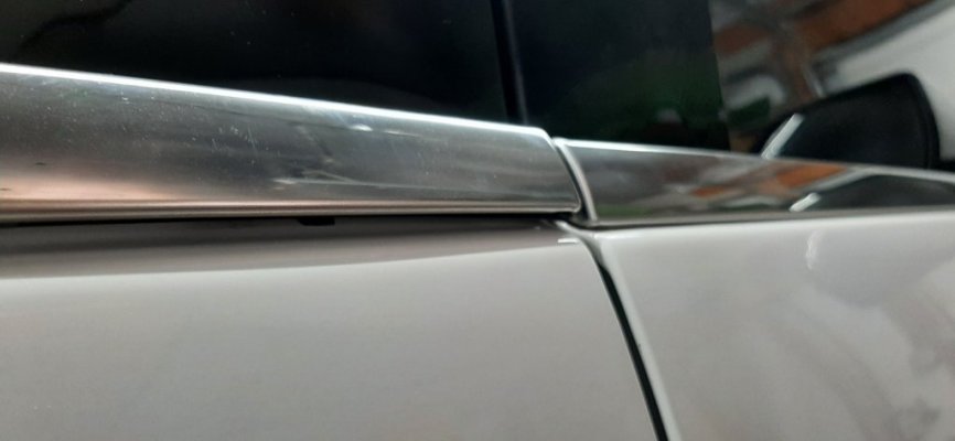

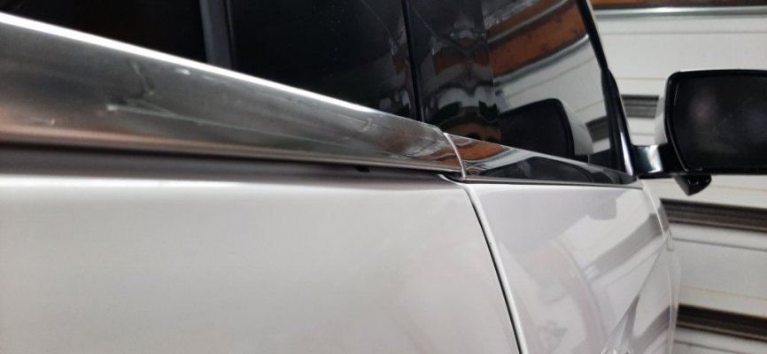

I was told the trans whine is normal. The service guy gave me some printout SSM50355 stating its designed as such. I found this out when I had it in for a pass rear window track replacement due to window grinding while going down. I need to figure out how to get this trim peice down since service technicians are about useless.
Anybody else's doors have a belly at the top of them not sitting flush to the rear doors? Reveal is good but just seems like the angle of the actual doors are off.
Also sucks not having a rear pass mirror like the previous 4th gen did.
