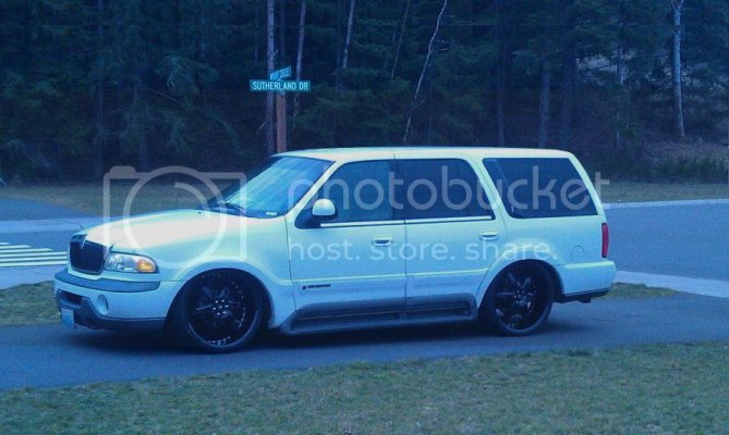

Yeah I know, terrible picture. Cell phone and Washington weather....

u want to know if those are 24's or if u should do 24's? They look like 24's...I'm thinking about bagging my truck but I drive it on trips too...if it will be bouncing all over the place I won't do it yet...

It was more like a "24's, WHAAAAAAAATTTTTTTT?" type deal LOL. They are 24x9.5 +18 offset on a 255/30/24.

My buddy has a bagged 52 F100 it drives nice.!! Got get the right bags for the weight and the right set-up for the suspension.

Can this be acheived with out baggin it on a stock navigator. Ive bagged a few trucks so not new to it. But it is my DD and i would like mine that low on 22's or at least lower than stock.

As far as ride is concerned bag size and placement is the biggest factor followed by how much PSI you run.
In the front I am running a firestone 2500 which is to small. I wouldn't run anything smaller than a 2600 so I am about to re-do the front to accept a 2600. Make sure you also get shock relocators for the front. I am running stock arms which is fine but if I had the money, I would opt for either the MMW arm kit or the Ekstensive arm kit. Both kits raise the upper control arms about 2" to correct the negative camber.
As for the rear I am running firestone 2600 bags which is very suitable. They are mounted with custom cups and sit in the stock spring location known as "over the axle" mounting. Not a great ride. For a good ride you will want to do a "bag on bar" set up. This is where the lower bag mount is on one of the link bars and the upper is on the frame (dependent upon where you set your bag).
Do not run anything smaller than the equivalent of a 10gal air tank (2x 5gal, etc), dual compressors (Viair is a good brand to start with, I am running 480's), and 3/8" SMC valves.
There are so many variables out there, how low you want to be, how fast you want the system, looks vs functionality, etc.
Anything else just ask!
