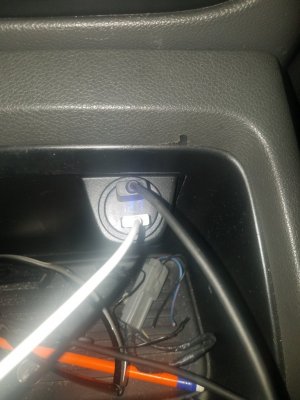

Yea, lighter is easy to take out. if you are talking about the dash one you just need to pop up the plastic "tray" in the bottom of the tray in front of it, and use a 7mm socket to remove one bolt. then open your console lid, grab the area between the cup holders and console and pull it up. unplug the harness and push the lighter out. then take a razor knife and cut off the two little tabs in the hole. Pop the new outlet in, tighten the nut that came with it, then cut off the factory lighter plugs and either solder or crimp on a couple female connectors. It's really easy

It really is easy. the rubber mat in the picture is what you need to pull up to get to the only screw ( comes out with 7mm socket)
