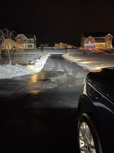

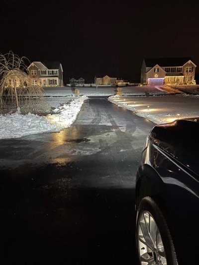

Just some pics of the light for reference 409ab48fe74ec0ce9d9168f353fcbd21.jpg
My driveway is 200’ and these houses r on 2 acre minimum lots. This thing lights up the house all the way in the back, pic doesn’t do justice.

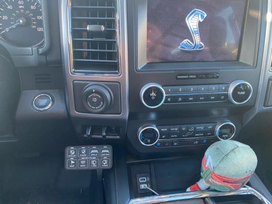

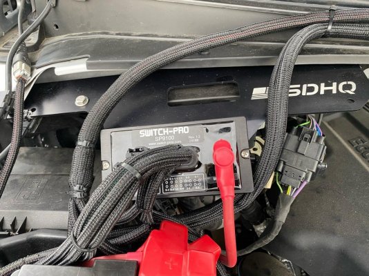

Even the Raptor Switch Pro mount for the Gen 2 Raptor fit. Fire wall is the same. Fenders are different.
Anthony DeVor
Nov 29, 2020
303
60
Maryland

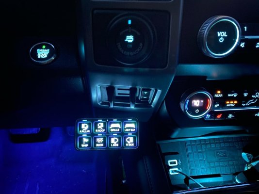

How did you do your switch panel inside
