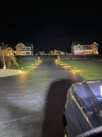

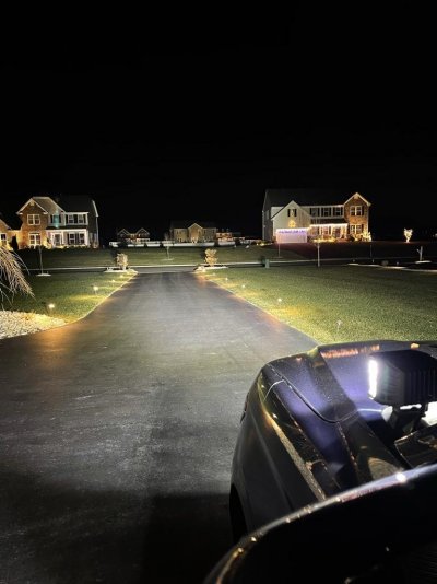

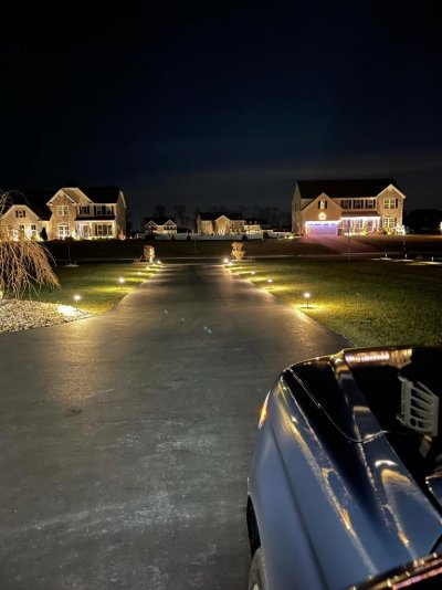

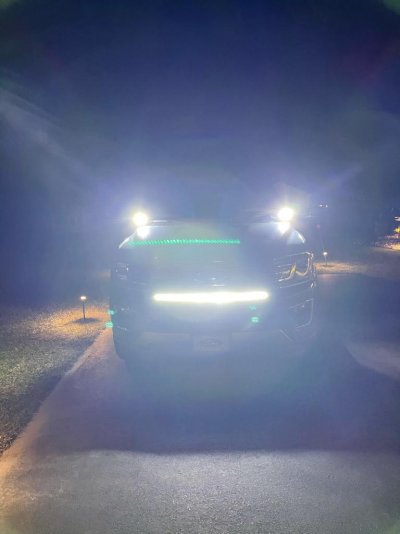

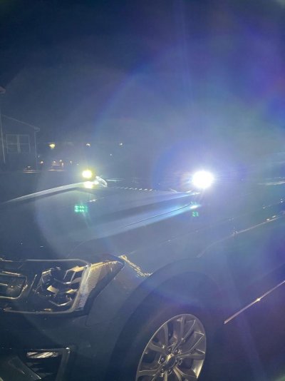

Just some pics of the light for reference 409ab48fe74ec0ce9d9168f353fcbd21.jpg
My driveway is 200’ and these houses r on 2 acre minimum lots. This thing lights up the house all the way in the back, pic doesn’t do justice.

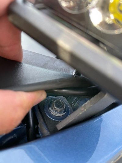

When I get mine installed I plan on doing a drone shot from the top comparing the stock headlights, bar and my A-pillars. I started to mount mine this weekend. I need to get longer bolts and some nylon spacers to put in the bumper gap.

Yup, that’s exactly what I ended up doing as well. Longer bolts and stainless steel washers with self locking double lug nuts.
