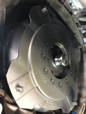

Trans is out, didn’t feel like continuing more today. Converter install and re-assembly tomorrow.
