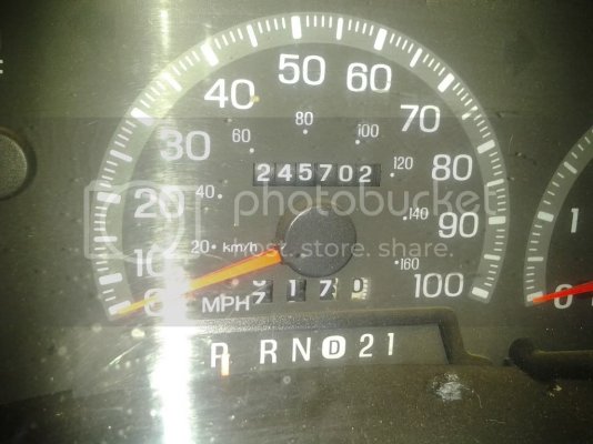

I'm currently in the process of removing the old T Case (first time working on a 4WD). So anways, here's a couple of pics as she sits now....
My slow progress so far, yes I'm embarrassed!!
Quite a few miles on the clock....

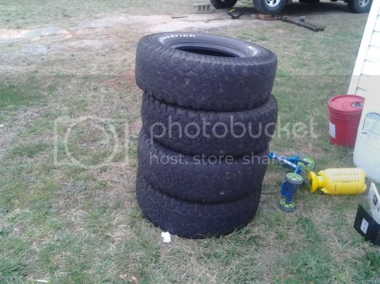

Anyways, as I'm on a budget, I scored four gently used 285's for $75!!!! Definitely an upgrade over the existing bald tires!!!
panda24619
May 18, 2010
5,501
42
San Diego
idk if thats an upgrade... those bfgs are pretty bald. but yes better then what you have on there now. haha congrats on that steel. not too bad for $800. get a junkyard t-case same year or a 97 and youll be all set. just bolts right up. reason why i say 97 or 98 is because of the out put shaft. on the 99+ they dont have a VSS gear. you wont be able to drive with out it. it tells how fast you are going and the computer how fast the truck is going. so a 97 or 98 t-case will work. just an fyi. other than that take some pics of everything you can. sounds like you have a funn project ahead of you!
