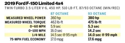

We get in to this every time.
I never mentioned the cost...it isn’t a factor to me...sorry. I bought an 8 passenger boat. I expect fill-ups to not be cheap. I used to drive a diesel 250 when it got close to $5 a gallon. Everything below that is just a win.
As far as the power, I guess Car & Driver’s numbers must be wrong. Seems like a big difference across the board to me...but OK.
I feel the difference, so did the wife. The MPG increase slightly lessens the hit of the cost.
It is tuned now, so 93 or E85 depending on the tune.
Bottom line, if you want to see the stock advertised power on an EB powered Expedition, you need to run 93, or at-least 91...if that is all you have.

I agree with your logic Loki but something seems odd about those figures...not sure the source. I have a video of a stock 2007 5.4 3V Expedition on the dyno and it puts down 250 horsepower and 300 lb ft torque to the wheels in 2WD which translates to drivetrain losses of about 16% give or take from the crank ratings. 16% loss is in the average range. These figures show the gen 2 EcoBoost making more torque at the wheels than Fords flywheel rating which doesn’t make sense. Subtracting 16% assuming the same drivetrains you’d yield lower #’s.

OOPS, that’s the Raptor HO EcoBoost! My bad. Yes 475 lb ft out of 510 lb ft checks out much better lol!
