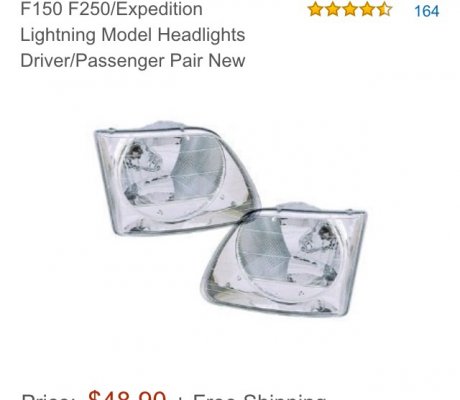

These are the headlights that I upgraded with two years ago. Even though they are cheap the light output was a great improvement (and still is) . I use Sylvania Silverstar bulbs.
I replaced the fog lights with some yellow halogen ones also from Amazon. I also installed a kit which allows the fog lights to remain on with the high beams (which has helped me a lot on dark rainy nights.)
That was from eBay and I'll be happy to find you the link if interested. I can't remember the exact bulb sizes but a Google search should give you a list.
