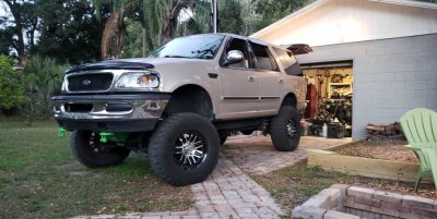

98 Expo on 37s needs a power plant upgrade.
Has anyone done a full swap with details View attachment 32979 as I have access to a full complete running 2001 svt lightning.
