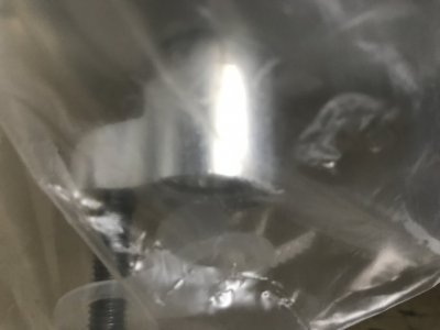

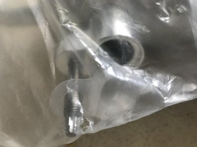

The flush, drier, oil, orifice tube, and condesor all got here today. Opened the box for the drier and the plug was off and the sealed bag had two holes in it at the bolt and the other end at the hose.
I ended up calling the distributor for tech support. The parts guy double checked with someone else and said that as long as the system is vacced down any moisture will be removed. They have been in the A/C business since 1974. Rich you probably know who they are, it's GPD in Macon, GA.
Not sure if I should return it I already have a return label. I believe you posted that the drier should be installed last and should not be exposed for more than ten minutes. The drier was in transit for three days and there is no way of tell if the plug came off before that or during transit.

We are having high humidity right now. I wouldn't chance using that drier seeing that it has been somewhat exposed to the ambient air. I'd send that back to them.
They are partially correct about the moisture but incorrect in not saying the desiccant inside may not function if it is saturated from already being exposed to humid air. It's function is to absorb any moisture as the system heats and cools during operation.
