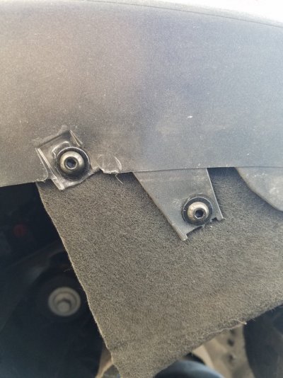

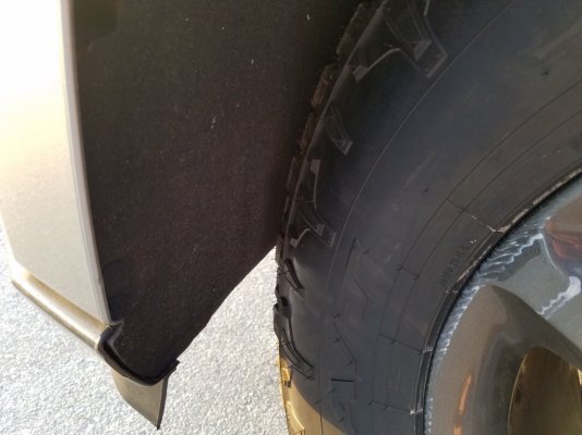

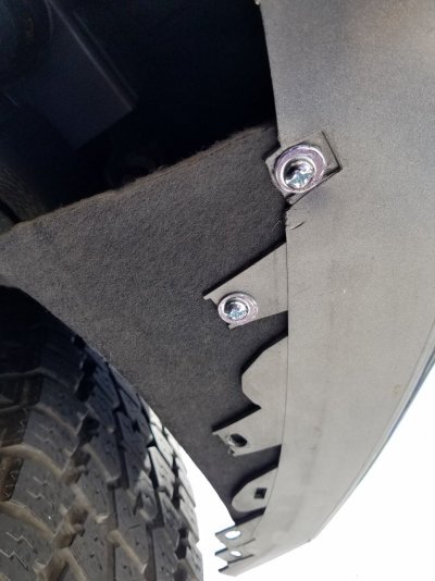

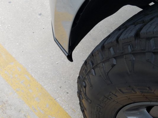

BEFORE:
AFTER
(and with a little cutting, sanding and then adding some sexy black items):
The cut to the lower valence looks pretty factory, and I kept the sharp "scallop" to match the lines. The point almost looks like it will hit the tire--but does not come close. With this mod, one can fit a slightly bigger tire than a 34.3 for sure, at least in the front for normal driving--no promises during articulation.
I will probably add another black Allen head screw per side (very large washer on the inside unseen to crush as much material down as possible) though I don't think it is truly necessary. **Whatever** bolts you use, I recommend rounded heads as square ones can catch on objects and tear if you get hung up and back up off it.
The heavy duty Zip Ties are more sturdy and secure--and possibly unnecessary (especially two). And yes, I cut the tails off after I took the pic.
YMMV.

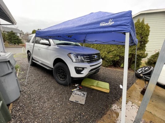

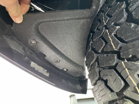

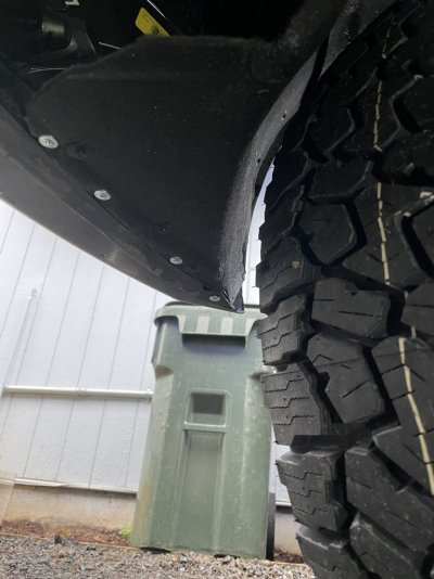

Thanks @Expedition Dave for the pics and write up! Referred back to this while doing mine. I pretty much did the same thing but I used the stock screws
and then added a few to tuck the lip in. Also, I opted to cut the horizontal portion of the valence and reinstall the rest. Figured being all plastic down there it could use any extra strength if/when it gets drug in the mud. I rounded the bottom trim piece a bit forward as well so the tip wasn’t so close. Very happy with how this came out.
