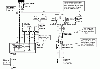

According to the wiring diagram the switch closes at 43.5 psi and opens at 23 psi

What is in the book and what I have observed are two different things. I've had systems that required jumping the low side switch while others didn't. Go figure.
The pressure at which his new switch closes really doesn't matter at this point. If he had a good set of gauges he could fill the system to spec then see if the switch has closed.
