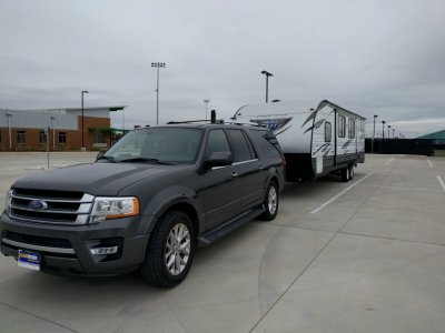

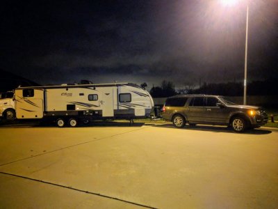

Unfortunately I don't have very good picture illustrating what you're looking for. When I installed the WDH, I didn't have a scale, so I measured the gap from the ground to the bottom of the front and rear fenders with the intent of minimizing the changes. Here are the only photos I have. I arrived late at night after driving from Texas to California. The stabilizers were down, but they didn't lift the trailer, just kept it from rocking. The vehicle is a 2017 EL Limited.

This sounds like more weight needs to be shifted to the front on your WDH setup. Guidelines provide for 10 - 13% of the trailer load to be on the rear hitch. I may be useful to take your trailer to a commercial scale to get the weight, then use a tongue scale to get everything distributed correctly. Here are some simple instructions below to get the tongue weight. It uses the combined weight - vehicle weight to get the tongue weight.
  • Drive only your vehicle onto the scale with the loaded trailer attached; make sure all four of your tires are on the scale.
  • Take the weight measurement, and this is measurement X.
  • Detach the trailer from your vehicle while your vehicle remains on the scale.
  • Take the measurement, and this is measurement Y.
  • Now subtract Y from X, this is your approximate tongue weight.

Should be a drop on both front and rear if the weight is distributed correctly. I don't think WDH is thread jacking, as this the proper resolution for sagging issues when towing.
