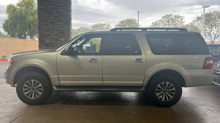

I have owned our 17 expedition EL for a while and it has 134k on it with a S&B intake and 2” leveling spacers and still running great. After a search here I see so many different tuners people run. I just don’t any a basics simple upgrade tune but am not sure still who to go through. Also I am thinking on getting raptor wheels for the offset and cheaper tire price. I have not found a 17 body style with raptor wheels on it even through search for some reason. IMG_6183.jpeg

Just be aware you will need to trim/cut the ends of the rear drive shafts as the threaded end of the drive shafts will interfere with the center hub cap. If you have an angle grinder it’s very quick and easy to do.

Not to bad looking. I’ll send a picture of what I have now. I put 1/4” spacer on my factory wheels last week to make sure the offset of a raptor wheel would not rub as much as I do already. I could go down a tire size but I’m not going to.
