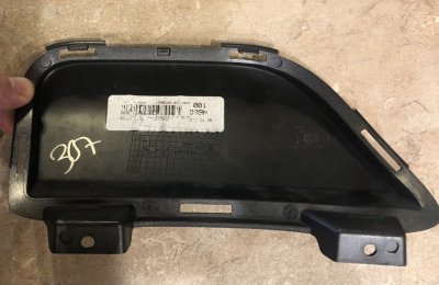

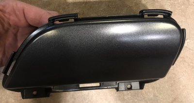

Am having difficulty removing the tow hook panels. Seems they will push in once tabs are released? Any more tips on removing them?
wakeboarder
wakeboarder
Nov 16, 2019
811
468
Fort Lauderdale, FL
It has been a while. I seem to remember it being a little difficult. I think you are correct. Unlatch the tabs, then push it inward. I think pulled a couple harness clips so I would have easier access to the tabs. Here are a couple pictures of the cover that may help.

Much appreciated; pics really help. Will have another go at it- didn't want to break off tabs.

Got it done; the trick is to start at the top, push up with heavy flatblade on the tab then tap cover on outside with rubber mallet. The first one I started at the bottom and it was hell. Decided to start at top on the other and it came right off- didn't have to depress the side tabs at all.

Hadn't seen this thread before starting and didn't get the Bumper Cover Spacer Panels until today. They go in from the outside then clip to top fins first. Fini!
