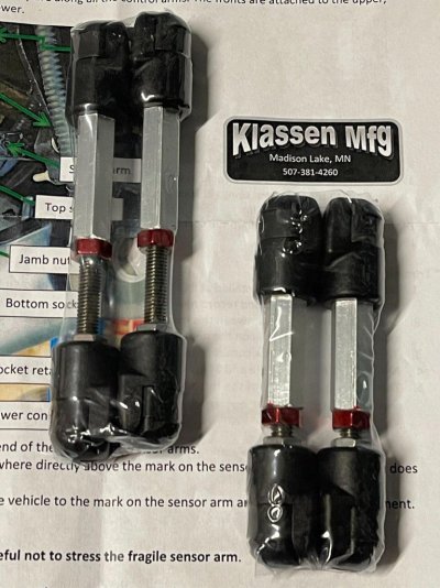

Ordered a set of these and they arrived quickly. Nicely packaged. Each pair was even shrink wrapped together with installation instructions to mark the angle of the CCD arms.
I didn't know about them until after the Readylift kit was installed. How can I determine what the angle of the CCD arms should be adjusted to?

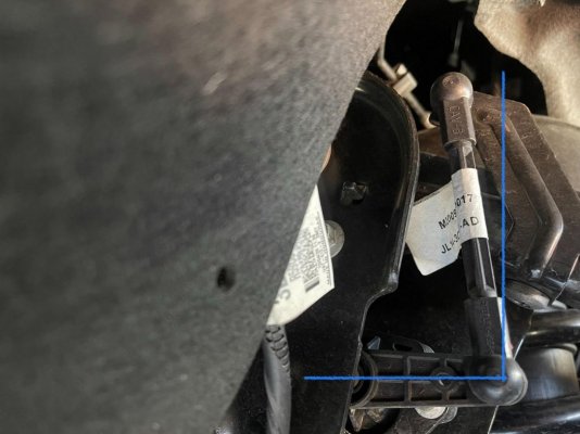

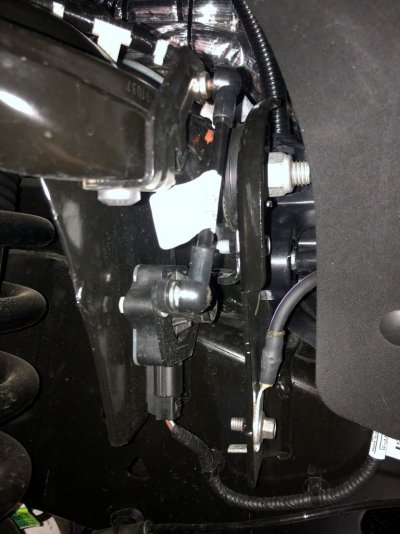

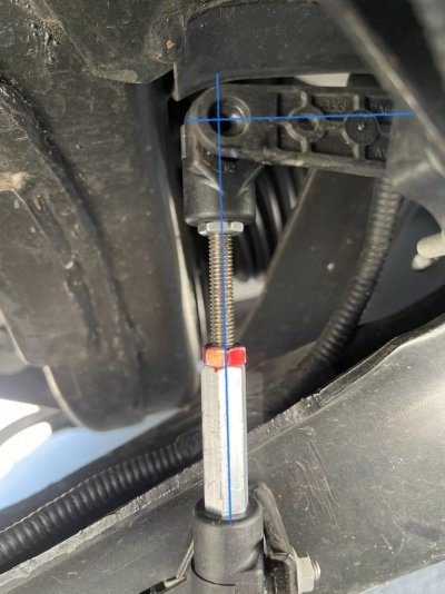

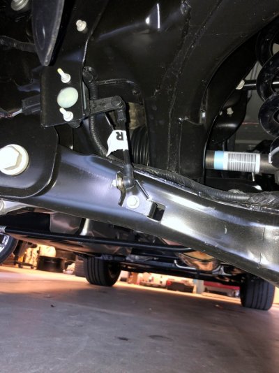

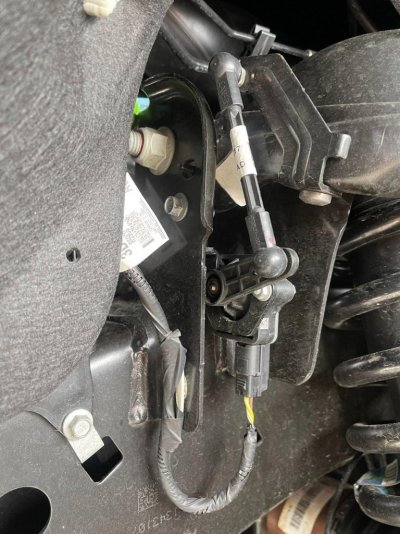

What I have been able to determine by looking at and measuring a number of Expeditions, is that the factory link to sensor arm angle is nearly 90 degrees in most all cases. I would adjust my links to that as a starting point. A Utah truck builder also told me that that puts the programmed numbers nearly exactly where they were before the lift.
See pics:

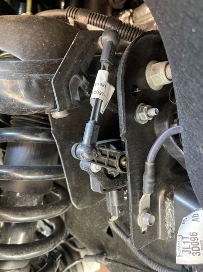

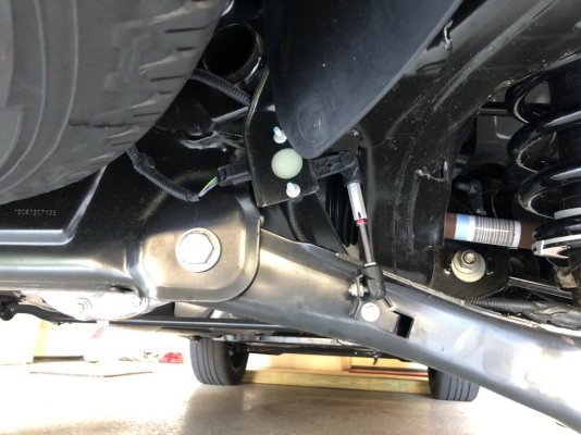

Got a picture of the link installed from the Utah builder. He took a sensor reading (maybe with Forescan) and set the link to get the same exact number after the lift install. He says it appears to be at 90 degrees. Without an actual scanner that can get the sensor reading, that's about the best you can do.
