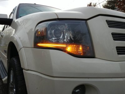

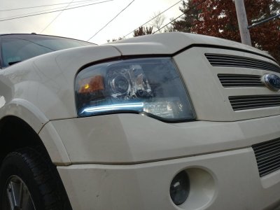

This is an earlier gen 3 but I filled the empty area with a profile pivot switchback strip. Parking light is white then switches to Amber when the blinker is turned on. It look blueish in the pic but it's actually pure white

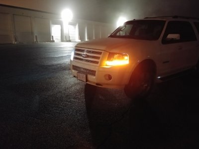

Couple night time shots. They are extremely bright btw. Second one is with the exposure turned way down so I could get a decent picture

I have a full bi-xenon projector retrofit setup, the LED strip was added during the build process to light up that strip.
