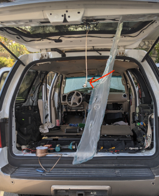

I think you can open manually by applying 12v. You need to take the panel off. I recently added an unlock button, but mine is set up so it only works when the car is unlocked.
