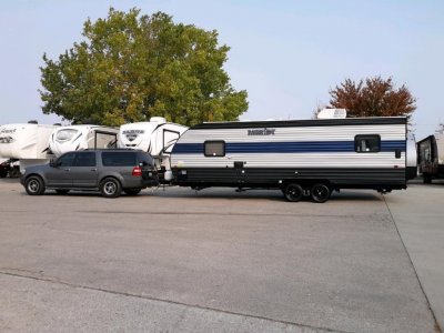

Am I overloaded? 28' Bunkhouse...

You should be fine. I tow a 30' camper - about 33' to the ball. 6500lbs or so plus maybe 750lbs of "stuff". The WD hitch is the key. Get it set up and maybe some fine tuning adjustments you should be good to go. I pump up my tires to 40psi and trailer tires at stated max. Remember - most trailer tires are rated at 65-70mph max. Invest in some Goodyear Endurance or similar for the trailer tires.

Yes, your tow vehicle is not adequate! I tow a 25' ORV trailer and consider it the maximum I would tow both for weight and wind effects on TT surface areas...You need to jump to at least a 3/4 ton pickup, you and your family are worth it!...

I like the "80%" rule. Stay within 80% of your max tow and you should be fine. That RV has a 7,745# GVWR which is over 80% and good place to start. BUT this RV has 2,090# payload capacity. Towing with empty tanks it's hard to imagine you'll load it down with 2,000# of gear. More than likely you'll be under about 6500# fully loaded. Unfortunately, the only way to know for sure is to pack it full of everything you'd take and go to scale.

You may find the heavy tongue weight with family in the car will make the rear end pretty bouncy. You'll likely end up with about 900-1000lb on the tongue/hitch, leaving you only about 400-450 lb for cargo in the Expedition.
I would recommend upgrading the rear suspension. Some options:
- Rancho ReadyLift (comes w/ springs & adjustable shocks which can be dialed up while towing to quell the bounce.
- SumoSprings (different for stock vs. Ranchos) to improve dynamic load (slightly higher effective spring rate)
- Hellwig 7688 upgraded rear sway bar makes it more stable with crosswinds, and as a bonus, improves handling while not towing.
- Load Range E (LT) tires to stiffen up the ride and handle heavy loads.
I tow a 2018 Rockwood Mini-Lite 2509S, sometimes with water in the front tank. 6500lb fully loaded with tongue weight between 900 to 1100 lb depending on if we're carrying water (yes, a tad overloaded). The Expedition barely does the job. I really wish I had stiffer springs and shocks all around, but the adjustable shocks definitely help. I'm not quite yet ready to go with Kings as they're quite expensive.

The hitch has anti-sway built in from what I see on their website. That was one of the main reasons I went with it.
From their website https://www.huskytow.com/husky-towing-32218-weight-distribution-hitch it reads: "Includes Sway Control With Built-In Sway Control".
I use that model Husky and it works well when configured correctly. The biggest issue you'll encounter is that the trailer is going to chew through your payload. You'll need to add around 80 lbs to account for the WDH weight...now you're at least at 825 on the receiver. I can't tell if that hitch weight from the manufacturer is dry or weight. If it's dry that's a problem, because you have to add battery, propane, etc. There's no margin to add anything else. Also, to minimize sway, you need at least 10% of the trailer weight on the tongue, but higher is better. You won't be able to go any higher if your payload is maxed.
I suggest renting a trailer close to what you're seeking, loading it up, and visiting a scale. It's much cheaper to do that than to make a purchase and find out it doesn't work. I see people posting all the time about white knuckle trips. Some of it is probably improper loading, but I think they also purchase trailers that are too large. Try before you buy.

Prior to this thread, we ended up taking this rig through I24, during a storm, at night, between Nashville and Chattanooga. This is described as the most treacherous stretch of interstate in the United States, arguably, and by Johnny Cash, because of the sharp turning and incline/decline.
It was slow going, we kept with the semi's, but the rig actually did pretty well. We loaded very light, three changes of clothes for each family member, some light groceries, and a few tools.
A couple of big things I forgot to mention were the new tires and brake controller we had on the rig as well. Both substantially helped keep things rolling very well:
The tires: https://us.coopertire.com/tires/discoverer-at3-lt
The brake controller: https://www.amazon.com/Hopkins-47297-INSIGHT-Brake-Control/dp/B00C5THYIK
We ended up driving all the way down to Florida from Indiana, and back to Indiana through the mountains of South Carolina. There were a few moments of learning what the bow wave effect was on the vehicle (Semi's sucking you into their lane). Bow wave was simply handled by never going above 65 MPH (it only takes REAL effect when going 55+MPH), and staying to the far right lane, when possible. Never at any point did any trailer sway (uncontrolled back and forth motion) occur, or feeling like the rig was out of control. We as well drove through numerous storms, none of which were too bad. BUT as soon as there was ice involved, we stayed put for a few days in a hotel.
Along the trip we did find out the front struts need replaced... They were on their way out, and at the middle of the trip, were full on needing to be replaced.
There were a few times when a "bouncy" like feeling happened, but as soon as I slowed down, it cleared up. I think a lot of this had to do with the front struts going out, in addition to the heavy load, but also there were simply some bad interstates.
In the long term, we loved the trailer, and will keep it. We will probably not go cross country often, but when we do, keep it slow, and in control. But ALWAYS with a weight distribution hitch and anti-sway. Without it, the truck simply cannot handle a load this size.

Glad you had a good trip and vehicle towed fine. Would just be careful that you stay under the gross combined weight. If you were ever in an accident and found to be overweight, it could be a real bad deal to the pt thag insurance may not even help due to the liability of being over the safe recommended weight.
