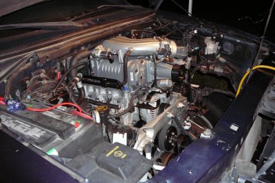

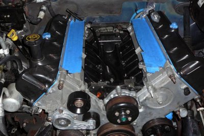

Yea !! Finally have my built long block assembly.:pepper:
MHP 5.4 lightning longblock assembly with TFS heads, Comp cams 102500 (MHP stage 1), Manley H beam rods. ARP rod bolts, main and head studs. Built to handle 900+ hp.

Still have a long road ahead of me getting it installed.:hmm: While waiting for the motor I have home ported the blower, intake, and upper plenum. Will add some pics.
