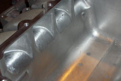

Check my previous post above..... I have ported it. The blower was relatively easy... the lower intake is a pain in the a$$. Too many different angles to work with. Since I am going with tfs heads I wanted everything before it to flow as best as possible so the tfs would be more beneficial. Box stock tfs heads are supposed to flow better than fully ported PI heads!! But damn are they expensive. I only plan to port match the tfs heads to the intake. Untouched otherwise.
I am hoping all this improves not only power but efficiency when I can manage to keep my foot out of the throttle..:hmm:
I had great success with my mustang home porting it. Heads, intake, plenum...etc.

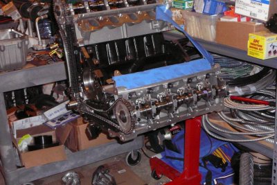

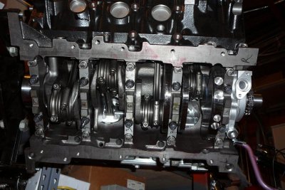

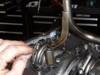

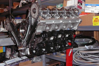

Yea !! Finally have my built long block assembly.:pepper:
MHP 5.4 lightning longblock assembly with TFS heads, Comp cams 102500 (MHP stage 1), Manley H beam rods. ARP rod bolts, main and head studs. Built to handle 900+ hp.

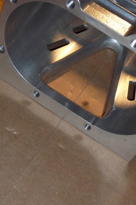

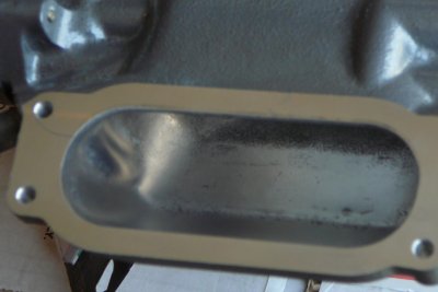

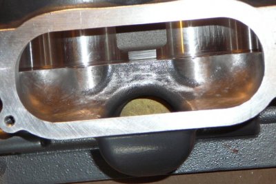

Still have a long road ahead of me getting it installed.:hmm: While waiting for the motor I have home ported the blower, intake, and upper plenum. Will add some pics.

Plenum

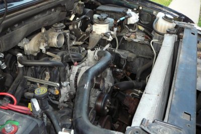

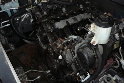

Begin disassembly day 1. Maybe 1 hr in it....another hour studying what it is going to take to remove the block. Wish I had a lift. It would be much easier removing the body for access.
toms89
toms89
technical advisor
Mar 13, 2011
5,173
442
MD

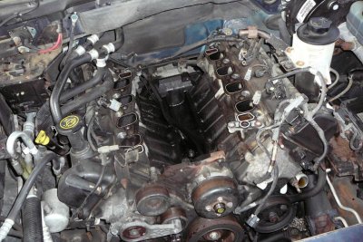

Expy disassembly day 2. Got a few hours in today after work..
Took a few more pics..... boring....lol

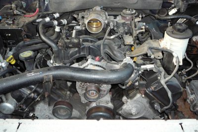

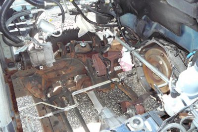

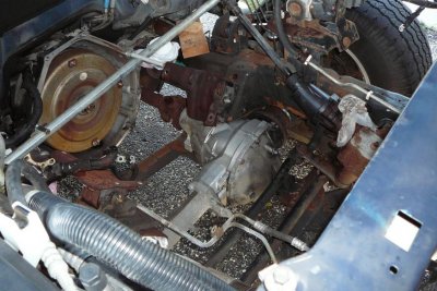

Expy disassembly day 4......motor is out!

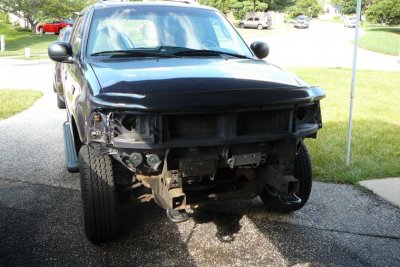

Had to remove bumper to get lift far enough back to reach center of motor.
Think its pretty mean looking...lol

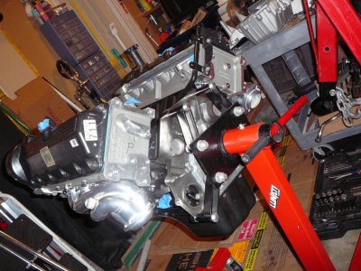

Well its been just over a week since I first started pulling the motor and the new motor is almost ready to drop in minus all the trimmings. Its been quite an adventure. More like P.I.A.... reminds me what I disliked about working on my mustang. Nothing goes as planned.

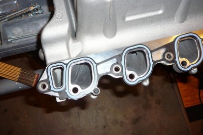

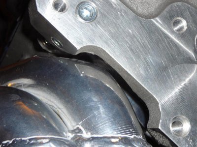

Went to install timing cover.... bolt holes in tfs heads wrong size for 5.4 setup.:wtf: Sooo... Drilled and tapped got cover on. Went to install canton windage tray. Doesnt even come close to fitting with stock pick up tube.:help: Cant even modify it to make it fit so its going back. Had to cut oil pick up tube pedestal down to get proper clearance from oil pan.... Glad I checked this because the ARP main stud nuts are larger than stock bolt heads.:hmm: Went to bolt BBK headers on and refuse to use paper style gaskets they came with. So I get the felpro metal gaskets (same as stock) and of course they do not fit with the larger exhaust ports of the tfs heads. :facepalm: So I modify them to work. Get the passenger side header on and go to install the drivers side header and it does not fit!! :emotions122: Well...... After some modifications with a hammer and die grinder:biggun:.... perfect fit.
I did leave out all the things that have worked. Just venting some of my fustrations of today...lol. This just reminded me of what I already knew. When you venture from stock.... there is no such thing as a bolt-on.
I just hope when I am all done it will have been worth it!!
