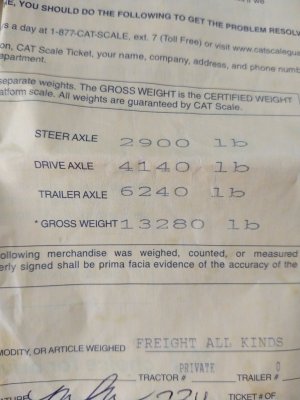

I Just weighed Saturday in prep for our trip out west this week. With my Reese Stediflex WDH - here are my weights from the CAT Scale:
Steer (Front) Axle - 2940
Drive (Rear) Axle - 4220
Trailer - 5740
Tongue Weight - 860 (13%)
My Gross Combined Weight is 12,900

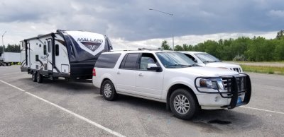

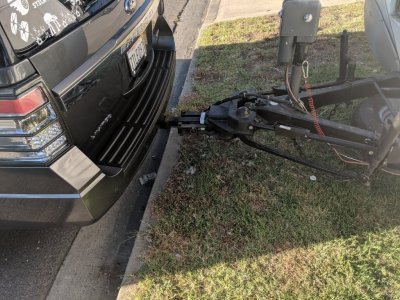

I would recommend adding a sway control bar to your equalizer hitch if you don't have one. I have a 2017 Expedition Limited and tow 28.5ft 2016 Nomad with flat front and high ceilings. I use equalizer load bearing hitch with sway control bar. It tows great mostly without swaying but with high ceilings, it is scary when 18 wheelers pass by. The draft really pushes hard on the camper and can cause sway. To minimize this I stay under 60mph and stay in the right lane on highways with semi's. If I go over 65 the big rig draft can cause my expeditions sway control to kick in. Just hold the steering wheel hard and let it pass.

The Equalizer E4 has built in sway control
