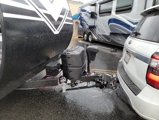

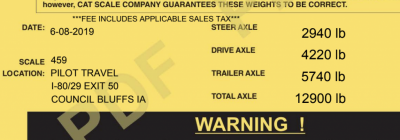

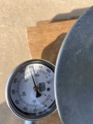

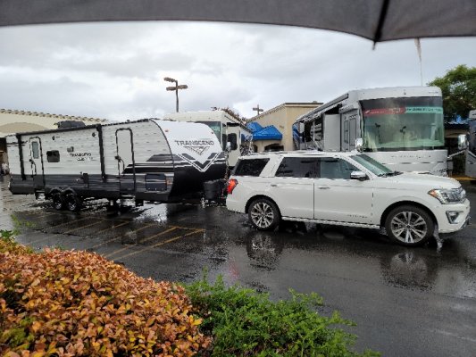

Hooked up for a short hundred mile trip. Found the scale weigh in too.

I’m not an expert but I think the steer and drive axle should be closer with no rear squat (if you have a WDH setup correctly). A squatted rear end will make steering a little more challenging.

while in theory that's how it should be, but you can't get there in any way shape or form. When setting up a WDH, its about the front end mostly. Measure without trailer, measure with trailer, and the WDH when set up properly brings the front back down to 1/2 way or a hair more when properly setup. The weight has to go somewhere, so some goes to the front but majority stays on the rear. There is no way to ad 1000 pounds or more of tongue weight and not have the rear squat, while some it does go to the front axle(which is the point of a WDH), 60% or more is still on the back axle.

I moved more weight off the back after I got saw the numbers. My wife didn't feel like waiting for me to make multiple passes on the scale because we were returning from a trip. It definitely improved the handling. Much less bouncy. We drove back from a trip today with some 20+ mph gusts and it handled fine. I plan to go back to the scale soon and make sure it's sorted.
You’re probably right, but here is an interesting video showing the impact of a WDH on weight: .

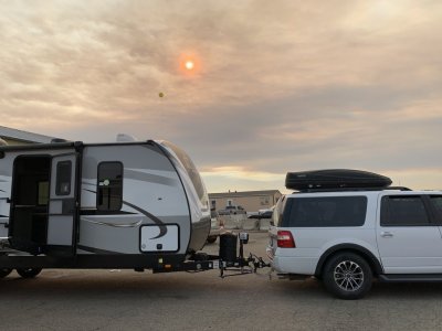

Thanks! It worked perfectly for us with our tow vehicle. As we have a large family and use the tow vehicle as a daily driver.
