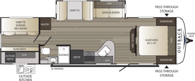

I don't know what the big deal is? I tow a 33 1/2' Keystone Outback 293 UBH that's dry at 5800, and has a GVWR of 7600 without any issues and it's the old 5.4 2 valve. I can't imagine having a newer 3 valve with a 6 speed or the Ecobeast!
A properly set up WD hitch is the answer to it all, don't cheap out on a crappy one that costs $300 and wonder why it sucks so bad, or it sways all the time...
I have an Equalizer E4 with 6 washers on the head, and a prodigy brake controller and have never felt unsafe... You will be just fine!
