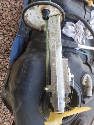

Pulled the tank, removed the pump. It was all corroded with a yellow and green sort of grainy or crystal like appearance. The rubber boot at the bottom is half okay and half melting and becoming sticky goo. Never seen this with rotten fuel. Some sort of chemical reaction? Thoughts please.

ETHANOL? And age more than likely

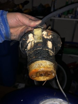

Sounds similar to what I found in the tank of my 86 BMW K100 motorcycle. The rubber boot holding the fuel pump in its holder had essentially transformed into this rubbery goo.
