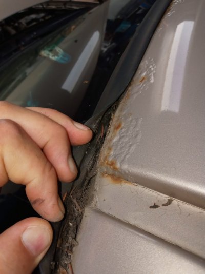

Found the leak. It's where the roof dips in for the roof rack. Where that channel meets the windshield. I pulled the rubber surround back and it looks like they loaded it up with silicone at one point.
I temporarily put some caulk in there and taped plastic over the whole area because it was going to rain again. It probably won't dry though. I also stuffed some rags above the headliner while it's raining.

... What?... if I don't have that weather stripping on it'll do That? well thats great I Really have to go get some then... I had to take that off last summer because it was dry rotting and was never installed right. Ive only ever seen a drop come in the car from that when I blasted the area with a hose.
Well I hope all that goes away for you and looks like I may need to run out to autozone tomorrow!

98EXPY 5-0, I hate to be the bringer of bad news, but if it is only a TSB, the dealership will not fix it for free. TSBs will only be fixed for free when under the original factory 3YR/36K mile warrantee. The fix is simply having the windshield removed and then re-sealed. It will cost you about $100.
