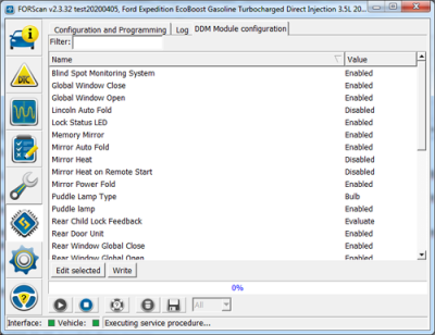

Okay, quick update for everyone, including @Bow512
I haven't clarified why there's confusion yet, but I've stumped the Forscan a little. to be clear, after a week with no response in their forums, I emailed the team directly and they responded. Effectively, they aren't sure where the "x84x" settings come from. I responded with a link to the F150 spreadsheet I think most of us have been using. Haven't heard back yet. But regardless, they responded with a link for a new version of Forscan that now includes a more automatic set of routines, one of which is the lincoln fold settings.
To my astonishment, so far it seems to have worked fine without the dreaded clicking issue (when using the memory settings), and without having flip flopped right and left controls. So here's what they said:
Use this version - http://forscan.org/download/FORScanSetup2.3.32.test20200405.exe
And do not use the as-built configuration windows for PDM/DDM. Use the non-as-built configs, in which you should see a window similar to this:
Make sure you do this for both PDM and DDM, but use the lincoln auto fold routine, and simply enable it.
This so far has seemed to work for me, and to be frank, the values for the fields after I ran this were:
DDM - 740-03-01: BCC0 C7
DDM - 740-12-01: FC56
PDM - 741-03-01: BDC0 C9
PDM - 741-12-01: FC57

I did hear back from the folks at Forscan, and given the global issues right now, I'm impressed with their responses. Couple things to note from them:
- First and foremost, they looked over the F150 spreadsheet most of us use, and its important to note that while many of the options are the same between that platform and the 4th Gen Expy, many of the values in the spreadsheet mean different things. They gave several examples and mirrors being one of them.
- They further recommended that using the ABD configuration is highly un-recommended, they truly want folks using the non-as-built modules, as those are pre-tested for specific vehicle profiles.
