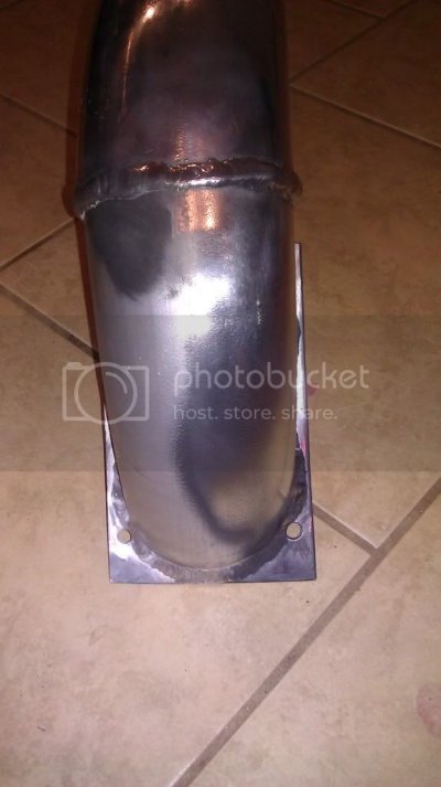

Here are some pics of the inlet i made for my whipple that fit under and around the firewall i made 7 if u need one lol
