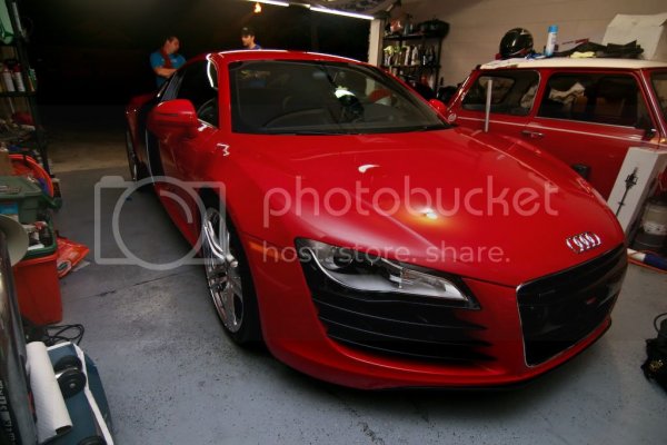

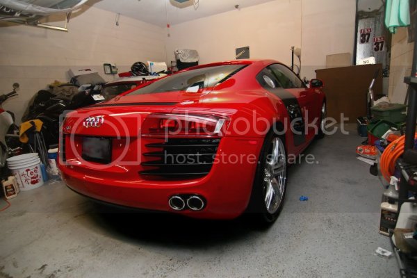

This is the lastest red car I did that I took pix of.
For that one, the steps were:
Wash -> Clay -> Wash -> M105/orange pad -> M205/white pad -> 3M Ultrafina/grey pad -> Danase Wet Glaze/gold pad -> Wolfgang Deep Gloss Paint Sealant 3.0
Black Wow was used on the trim.
