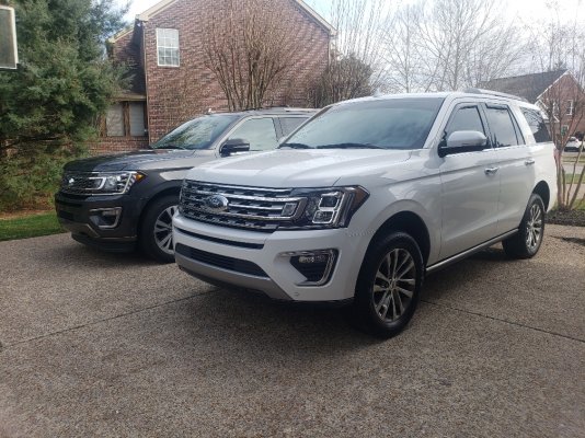

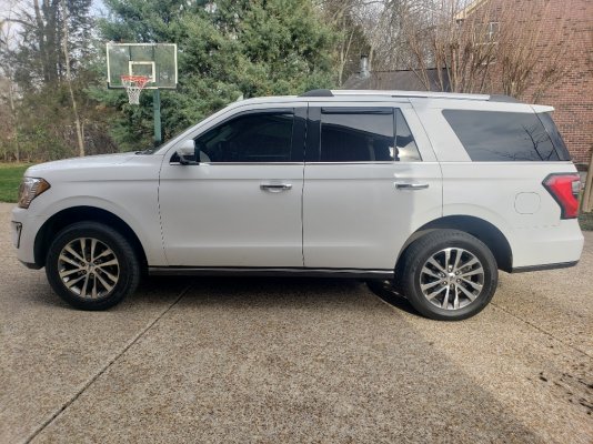

Finally wrapped up the Bilstein 5100 install this weekend.. just need to take it to get aligned now. I originally installed the Readylift 3/2 kit and then realized the front factory shocks were leaking. I ended up coming across the Bilsteins that they just came out with for the Expedition and after some research ended up buying the rears for the Expedition and the fronts for a 4wd F150. The front and rears for the Expedition state only about a 1.6” lift and I guessed that the front needed more to come close to what the Readylift kit is. After 3 adjustments on the F150 4wd shocks I ended up on the bottom ring which is stock setting and likely could have just used the 2wd shocks. I’ve only driven it a little bit as I want to get it align before letting my wife put any real miles on it but the Bilstein shocks have made a huge difference in stability and braking. Definitely happy I went this route instead of wasting time at the dealership. The height to fender ended out coming to the same measurements as the Readylift, just now it has more suspension travel. Anyways the only part that matters.. the pictures...
