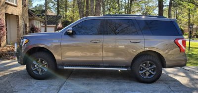

I'm running the 4WD F-150 5100 front's on the lowest stock setting and Expy rears on the highest setting. I was running the RL 3/2 before, and I'd say the stance is pretty close. The ride is a vast improvement over the RL w/ stock struts/shocks. Also replaced the stock UCA's with the ICON tubular Deltajoint UCA's that come with the full Expy ICON coilover lift kit.
Yep, @CE750 that looks about perfect to me.
I only wish that Bushwacker would make fender flares for the Expy like I had on the Tundra.
