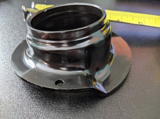

In an attempt to get this back on track, and to add an update, the Motorcraft rear shocks I ordered on ebay arrived just a few minutes. To confirm, they DO come with the spring seats, and they ARE removable so for you folks that have ran into this, or will in the future and find this info via search, you can get the removable stock type spring seats when you buy the Motorcraft replacement shocks.
The part numbers for the rear are ASH-12327, again, this is for the Motorcraft factory style shock with the reusable spring seat.
Now, the hell of it is, I don't know if I should use these and return the bilsteins or use the spring seats from the factory stuff and run the bilsteins and sell these shocks to someone who already have the springs seats...
EDIT, the Motorcraft shocks come with the reusable spring seat just like the factory stuff. That spring seat DOES fit on the Bilstein shock body.
