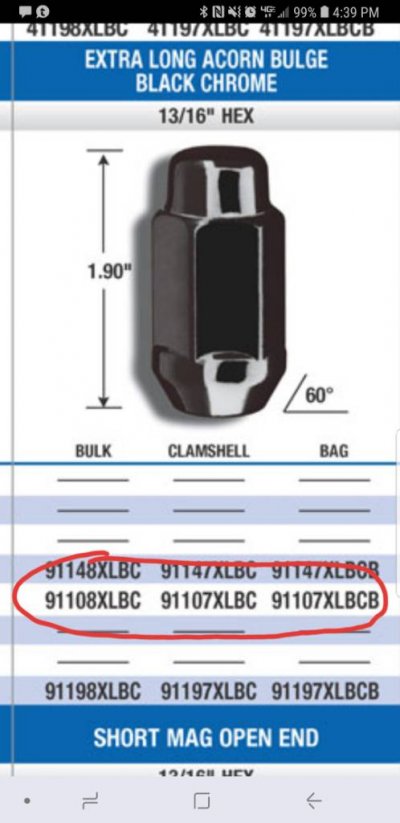

I ordered a set of these today for my Gen4 Expedition from summit racing.
https://www.summitracing.com/parts/gor-91107xlbc
Gorilla Black chrome acorn bulge lug nut, 14mm × 2.0.
The Gorilla part #s are
91108XLBC - bulk
91108XLBCB - bag
91107XLBC - clamshell package

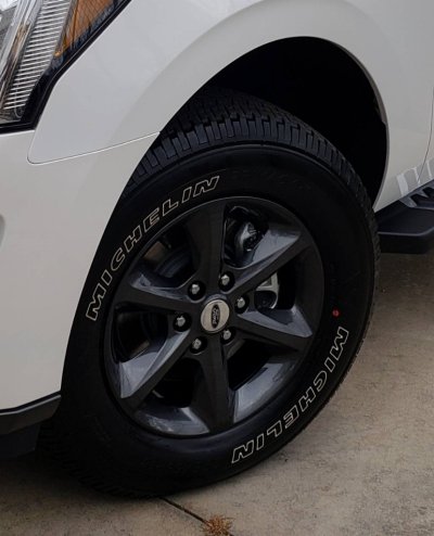

They will match the FX4 wheel much better than the chrome factory ones, and last much longer.
Before pic

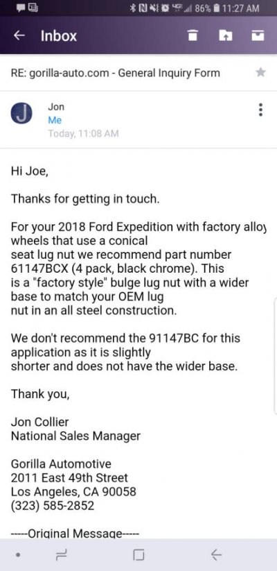

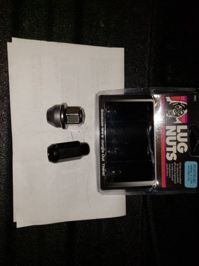

I ended up buying the wrong thread pitch. Ther correct one is 14mm x 1.50. I'll be returning the Gorilla lugs for the correct ones.
