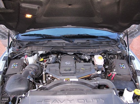

Here's perspective. My 1400hp daily driver diesel has a 68rfe(adaptive learning trans) in it which is a 100% built unit and the best of the best and it cost me close to $10k not including install. Even with having all the fanciest crap, and consistent driving habits.... All it takes is 1 "learned" characteristic to go out of whack and then you could be looking at a rebuild.
