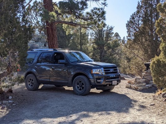

I came across this thread after I put 18" wheels on my 2015 Limited with CCD, and wanted to chime in. I chose 275/65r18 Vredestein Pinza AT and put them on Fuel Shok wheels with +20 offset (+44 is stock). I didn't experience any major difference in ride quality. It's a little softer, which is expected, and nice, but not overly squishy and handling is still good.
Previously with the dub deuce wheels I would keep it on "normal", but "sport" feels a bit better with these tires. The struts are original and have ~72k on them, and several are leaking pretty badly, so I need to replace them and will probably go with the non-CCD struts to save some $$ and because I don't think CCD is really needed with 18" wheels. If I remember, I will update once I do that.
Thanks for the discussion - this was useful for deciding what to do on the struts.PXL_20211104_004218032.jpg

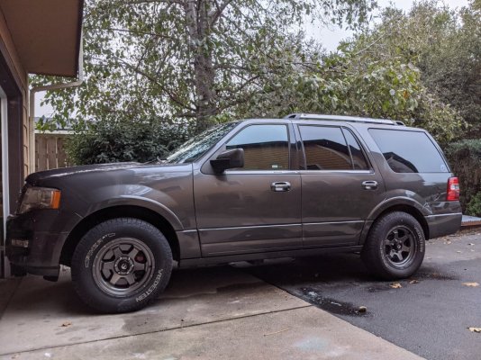

guzzon
Nov 4, 2021
Santa Barbara, CA
Update after replacing the struts with non-CCD: ride quality is not that different with the 18" wheels with and without CCD. CCD is definitely smoother but not by a lot with these wheels. I think where I notice it the most is the "bounce" from the back end that you'll get when you go over a bump, usually at highway speed, that has just the right timing to get it to bounce up and down. I think that's what the CCD was really good at sensing and dampening out. It feels much more like a truck in that respect now. I haven't towed a big trailer in a few years, and wonder how different that will be without CCD, if we ever get one again...
All in all I'm happy with the trade-off in $$ saved now and in the future if struts need to be replaced, and it's a capable backcountry road vehicle now with these wheels. Spent some time in the hills outside of mammoth lakes, CA last week and had a blast.
