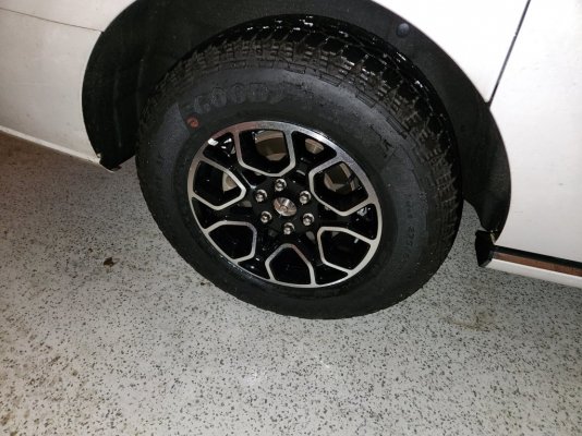

I'd like to know the answer before trimming the hub. Thanks

Thanks for the replies. I have a cutting wheel that should make quick work of it if I can't find my 1/4" aluminum spacers.
It's frustrating because the new 18" wheels look nicer to me than the 22's and they ride a lot better over rough roads.
I'll do what I need to do to get the rear caps attached.
