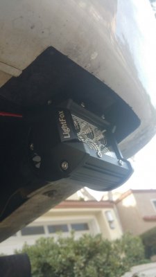

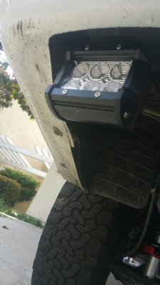

....+ about the same amount spent on 2x 5/16" drill bits that didnt much like "Built Ford Tough" frame rails (Irwin HSS, RIP, & offbrand Oreillys "Titanium", showing damage or defect), and same again on fuel driving around fetching that shit. Plan ahead get hardcore drill bits. BUY TWO.
+ hours wasted figuring how to mount it.
Solution: frame rail behind bumper. Drill 8mm or 5/16". Supplied bolt is M8 w/ 1.25 thread.
M8 1.25 thread wingnut useful on passenger side if you dont wanna take off the bumper, not enough space for a wrench imho... on driver side you CAN get a ratchet in though, helps to have the Bostitch twist-to-ratchet handle
Wiring? Easiest to splice into taillight (reverse light is the bulb behind the clear lens) and drop it thru the fender....greenish wire is hot, black and white is ground.

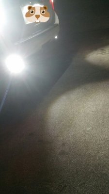

PS roughly 2/3 the light is coming off the pods...
+ slightly <1/6 from JDM Astar reverse light LEDs, but on a lifted Expy they just dont point in the right place really
+ slightly >1/6 from JDM Astar LEDs in license plate lights, those things are ridiculously bright and point DOWN, thats the dimmer but widest angle beam seen

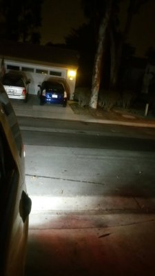

The pod IS under the bumper. The diode bulb in the taillight isnt THAT harsh, it just washes out the focus of a crappy cellphone cam when up close.
It's a non-projector that's weaker than most popular taillight bulbs on here
