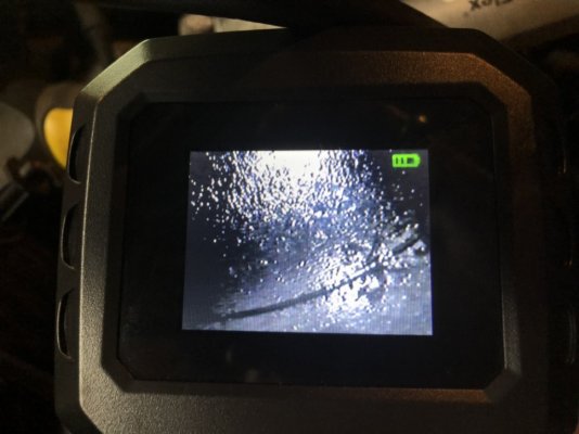

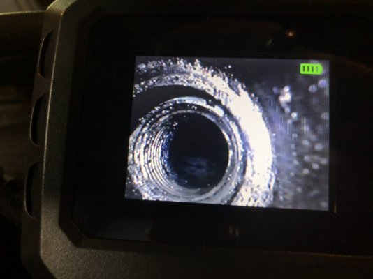

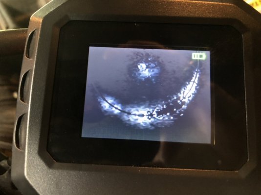

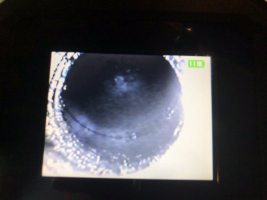

I got the tester threaded in #8 (I thought I did-it felt threaded in), put ignition fuses back in and cranked it over 5 times is so. Tester read zero. I cranked it again maybe 8-10 times and the gauge still was sitting at zero. So I decided to check the other 3. I couldn’t get the GD tester threaded into any of them so I’m thinking (hoping) it wasn’t really threaded into #8 either. I can feel it hitting the plug hole but it won’t thread in. The adapter looks to be the correct size-it’s just a cheap HF set. I’m looking for a better tester-any suggestions?
For the heck of it, I stuck the camera down on the #8 hole. I don’t really know what I’m looking for, but it looked way gunkier in there than the plug hole next to it.

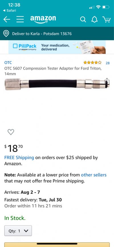

Am I going to need something like this? I did notice the threads on the compression tester adapter are much shorter than the plug threads. This adapter says for 04 and newer but this 01 seems to be the same as my 04 I just worked on-same plugs.
Atman246
Feb 11, 2017
76
40
Ontario,Canada
Looks like you will need the adapter. As for the pics,it's really hard to see anything other than the gunk you see. Does the camera have a light on it? Hard to tell. If you can,try bending the camera neck and have a look for the valves. If the valve is hanging down,it'll be like Moose said,possibly a broken valve spring. There was another thread in the third gens I think where the guy found that. That would be a relative easy fix if thats the case. How's the weather for this? It's hot and sticky up here. I need to work on my daughters Honda and aren't feeling too motivated.. Haahaha.

I did order the adapter-it should be here Thursday. The camera does have a light and it was on so I guess that’s as bright as it can get. I wasn’t really able to get it at any better angles but I’ll mess with it again sometime and see if I can get a better shot.
